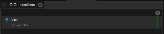

The Vicon IO can be added with a click on the (+) within the IO Connections.
Stage Precision can be connected to “Vicon Shogun Post” and “Vicon Shogun Live”.

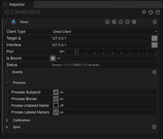

Within the Inspector the IP / Port and the local interface needs to be defined.
The following different types can be choosen to be processed from Stage Precision.
- Subjects
- Bones
- Unlabeled Marker
- Labeled Markers

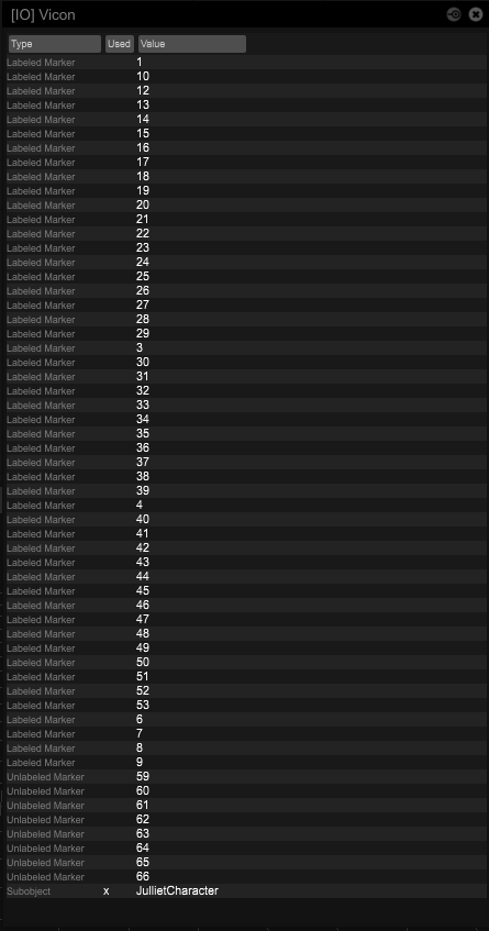

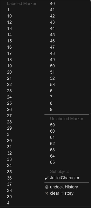

Map Inputs

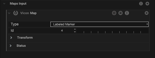

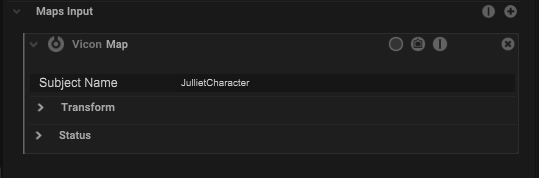

To link the incoming Vicon types to Tracker objects it’s necessary to add a map input.
Vicon has two different map inputs.
One for the markers and one for subjects and bones.
The subjects / bones needs a matched name.
The Markers needs a matched Id and the correct type (Labeled or UnLabeled).
