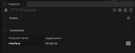

Send OTP from Stage Precision (Producer)
A sender within OTP called “Producer”.
The OTP Producer can be added with a click on the (+) within the IO Connections.
The “Producer Name” can be changed to identify the sending system.
The “Interface” needs to be the local network interface IP.

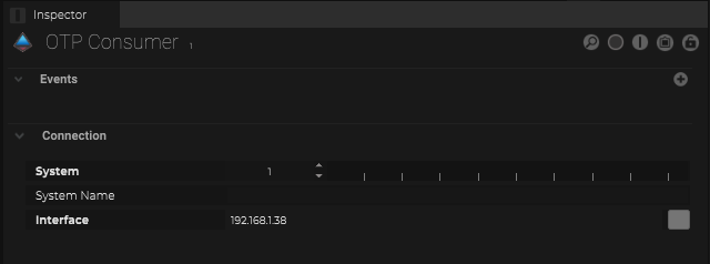

The OTP Consumer can be added with a click on the (+) within the IO Connections.
The “System” id needs to be defined an needs to match with the Producer system number.

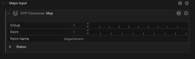

Map Input
- Group
Group numbers are intended to group together associated points, such as those on a single object.
- Point
Point numbers identify a Point within a group.
