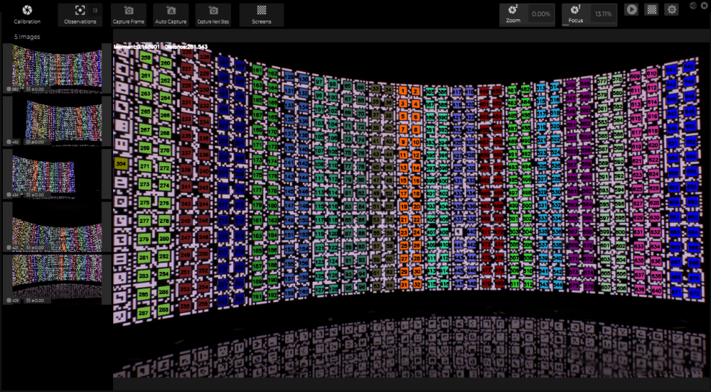

What size should have my markers?
The more markers the calibration system can see, the more points are avaiable for the calibration.
This is good for calculation of the lens distortion.
But at the same time the markers should not be to small, as the system needs to interpolate pixels.
So at the end how small/big the markers should be depends on the resolution of the camera image.
The markers should not be much smaller than what is shown in the below image:
The markers should not be much bigger than what is shown in the below image:
