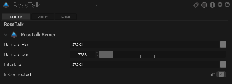

RossTalk Setup
| Remote Host | This is where the IP address of the server can be added. |
| Remote port | This is the port that the data package will be sent to. |
| Is Connected | When on, the device is connected. |

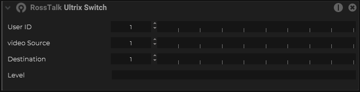

Ultrix Switch
Use to request video source be selected on destination for specific levels coming from User ID
| User ID | ID of the user for which the request is coming from |
| Video Source | The source of the video |
| Destination | The destination of the video |
| Level | Multiple levels are possible with a separation by a comma with no spaces and can include ranges. This is an optional |

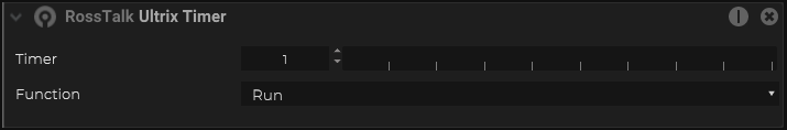

Ultrix Timer
| Timer | ID of the timer |
| Function | Have the option to
