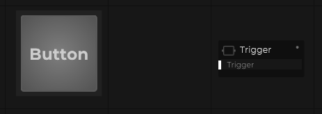

A input node from a compatible type needs to be at the board as well as an interface object

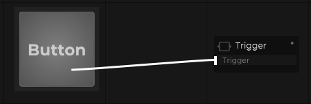

Drag the connection from the node on top of an interface object

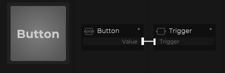

After releasing the connection a output note will be genereated from the interface object
