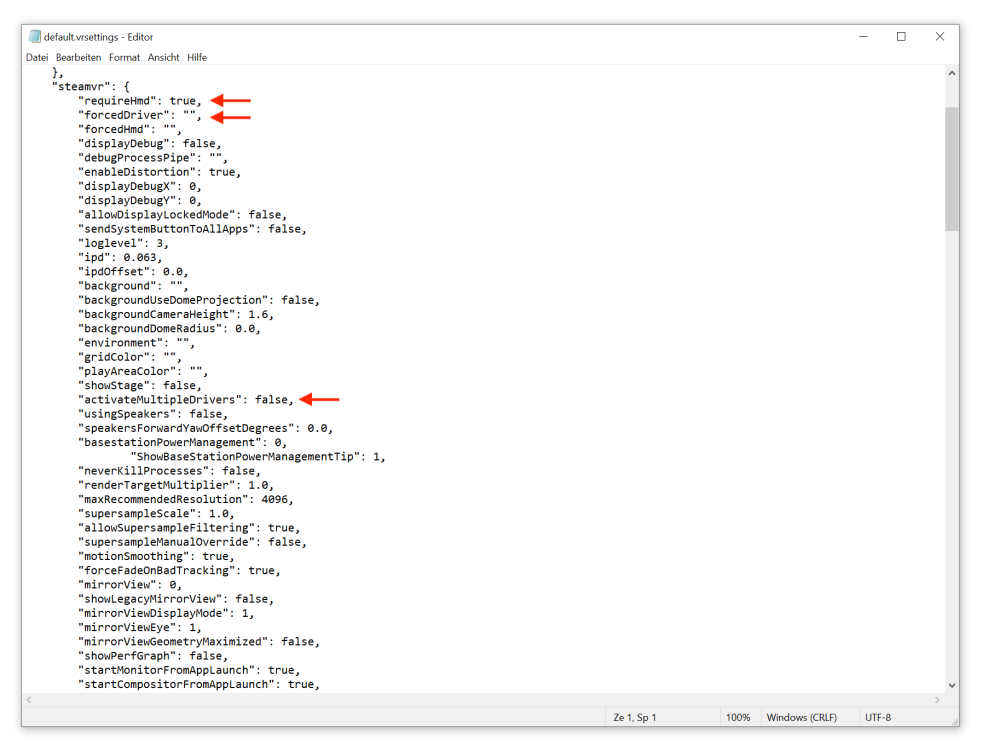

- Go to the following path:
„/steamapps/common/SteamVR/resources/settings/“
Open these file with a text editor: „default.vrsetting“.
- Search for „requireHMD“ and set the value to „false“.
There should now be the following:
“requireHMD“: false,
- Search for „forcedDriver“ and set the value to „null“.
“forcedDriver“: “null”,
- Search for „activateMultipleDrivers“ and set the value to „true“.
“activateMultipleDrivers“: true,
- Store and close this file.

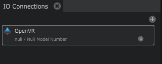

- Start Stage Precision and add a OpenVR IO.
You should now be connected with the Vive data stream.
- You can now add the tracker by clicking on the blue magnifying glass.
