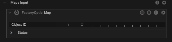

To link the incoming FactoryOptic data to a camera object it’s necessary to add a map input.
The object ID needs to be matched with the sending device, is by default: 1
