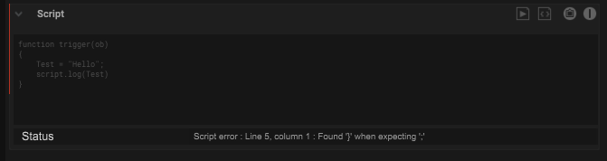

- The system log will also give information about issues inside of your script.
In this script is the “;” missing at the end of the 4th line.
The system log will return an error.
error : Line 5, column 1 : Found ‘}’ when expecting ‘;’
If you are using pool scripts. This error will also be visible in the “Status” inside the inspector.
