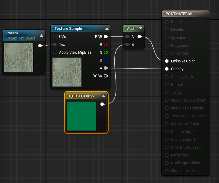

Add effects to the Live Input
A live input can also be manipulated with a “Post Process Material”.
