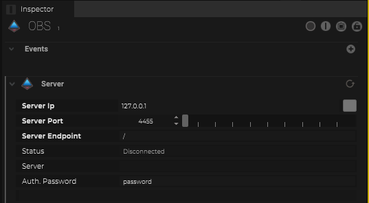

Add remote control within Stage Precision
To add the OBS IO-Connection, click on the (+) -> “Media Server” -> “OBS”.
Make sure that Server, Port and Password are matching the OBS settings.
