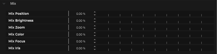

Bring all Mix parameter to the minimum.

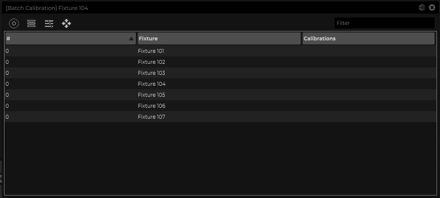

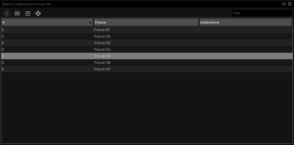

Start Batch Calibration
Select your fixtures and start the calibrator from the inspector.

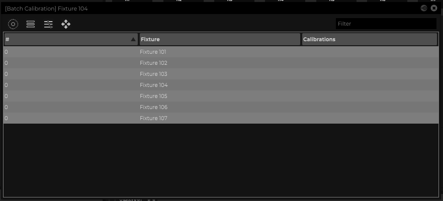

Select a single fixture
Select a single row/fixture which should be positioned.

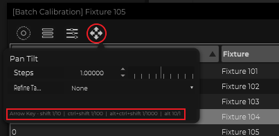

Set all Fixtures to Pan Tilt mode
Set the position to a calibration point
Repeat this with all fixtures
Position all fixtures to one calibration point before continue.

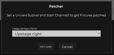

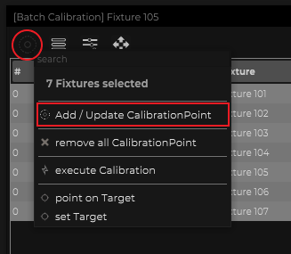

Add a calibration point
Choose from the dropdown the measurement point where the real light fixtures are “pointing/focusing” to and click on “Add or Update”

Execute the calibration
