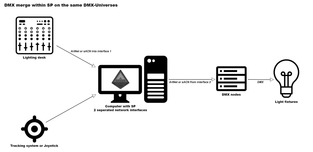

Merge within Stage Precision seperated networks
By using multiple networks, it´s still possible to have the same patch for fixtures.
SP is receiving the DMX network stream on one deticated network interface and send out on an other interface.
The merging will happen within SP.

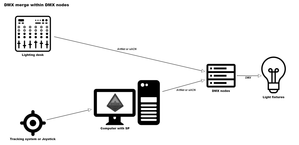

Merge within hardware nodes
Also hardware nodes can take care about the merging.

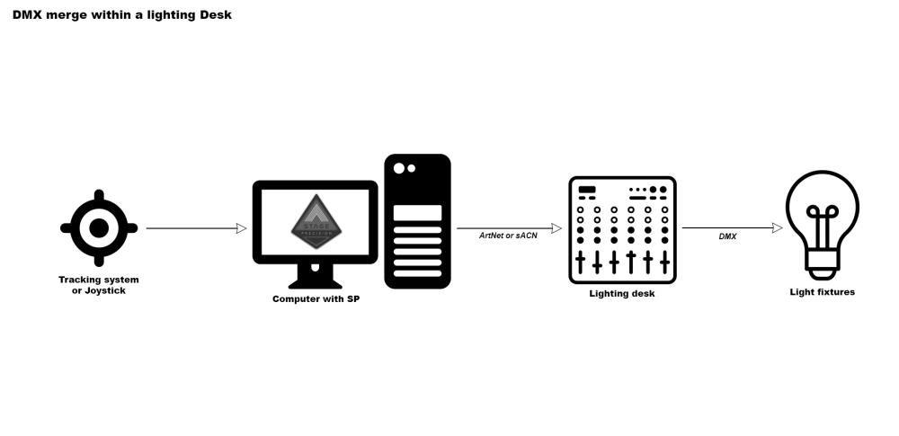

Merge within a lighting desk
Also a lighting desk can take care about the merging.

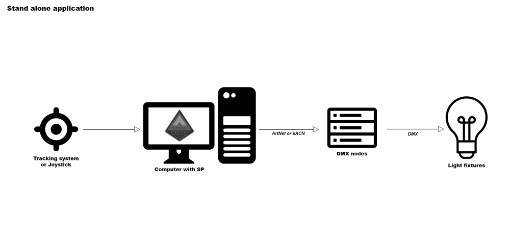

Stand alone (without any lighting desk)
It´s also possible to run SP only instead of using an addional lighting desk.
