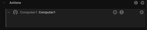

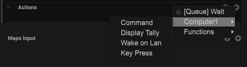

To send commands/events from Stage Precision to Gateway it´s necessary to have a action event map.
The name of the action menu is equal to the IO name:
Add a trigger from the following menus:

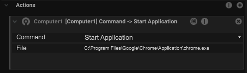

Start Application
Define a complete application path which should open. (include “.exe”)

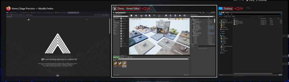

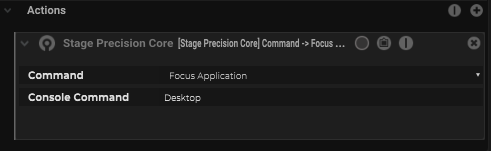

Focus Application
Can “focus” a application (bring it to the front) to send inter alia a keypress or similar action which needs a specific application in front.
Command needs to match the window name incl. lower/upper case.
The exactly name of a windows can be viewed by hold “alt + tab”.
To bring the explorer Desktop to the front, “Desktop” needs to be defined as command.
To bring the Unreal project to the front, “Demo – Unreal Editor” needs to be defined as command.

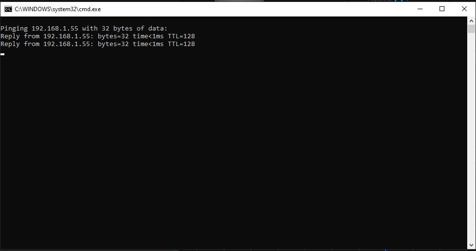

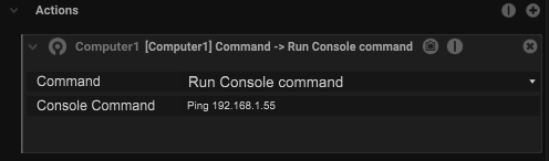

Run Console Command
Run the commandline with the given command.

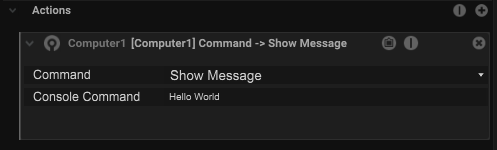

Show Message
Open a message window with the given text.

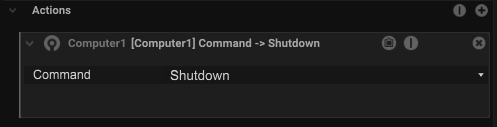

Shutdown
Shutdown the computer.

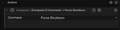

Force Shutdown
Force a shutdown from this computer.

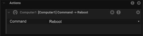

Reboot
Reboot the computer.

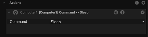

Sleep
Send the computer into the sleep mode.

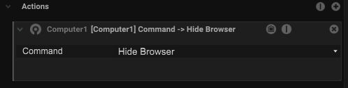

Hide Browser
Hide the browser if open.

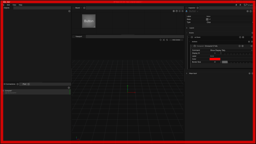

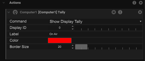

Display Tally
Show Display Tally
Shows a on screen “Tally” boarder.
| Display ID | Index of the Display where the Tally boarder should be shown. 0 = Display1, 1 = Display2 etc. |
| Label | add a Label in the upper left corner |
| Color | The color of the boarder |
| Border Size | the size of the boarder |

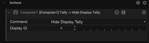

Hide Display Tally
Hide the on screen “Tally” boarder.

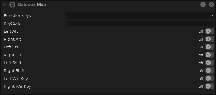

Key Press
Send a Key Press to the Gateway instance.
| FunctionKeys | A dropdown with some predefined keys. |
| KeyCode | the key code of the key |
| Modifier | The option to enable multiple modifiers at the same time |
