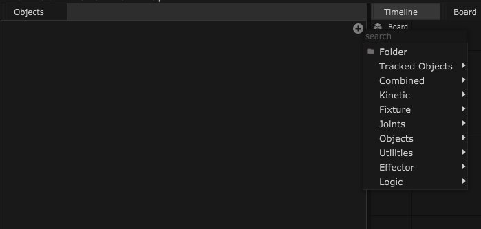

The objects section is where all fixtures, objects and structures are stored and arranged.
When SP initially starts up the objects view will be in the top left-hand corner. The objects section includes all of the scene building models, fixtures and shapes.
To add an object to the scene you first click the + icon.
The + icon or right-clicking in the application window, opens up the options:

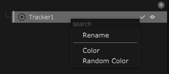

Display Colour
The object colour can be altered by right-clicking on the parameter, this will open up a search bar and colour option.
Clicking on this colour bar will open up a colour picker and any colour can be selected.

Renaming
The objects can be renamed by right-clicking and selecting rename or highlighting the object and pressing F’2’.
