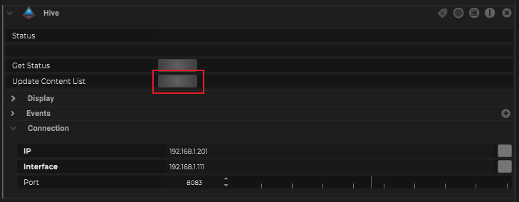

Setup the connection
Within the IO-Connection add a Hive IO.
Define the IP of the Hive player and choose your local interface

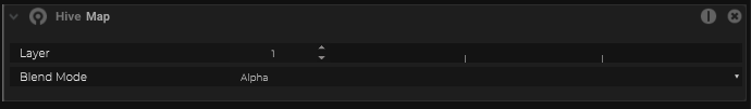

Blend Mode
define a layer which should to be effected
with the dropdown you can choose:
- Alpha
- Additive
- Multiply
- Difference
- Screen
- Preserve Luma
