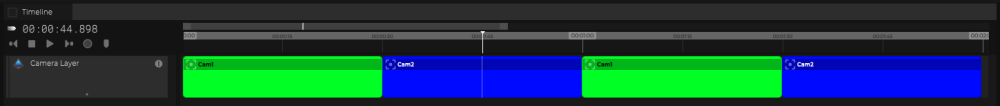

With a Camera Layer it´s possible to create a timeline with “camera cuts”.

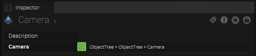

Each “Camera Block” can be assigned to a Camera object from the object tree.
The Camera Layer has an event system to detect a specified camera and can react on these.
It´s possible to use these to send “cuts” to a vision mixer.

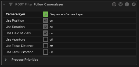

There is also a Camera specific filter, so that a virtual camera can be used to follow the camera timeline.
