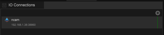

ncam Reality is a hybrid camera tracking solution.
The ncam IO can be added with a click on the (+) within the IO Connections.
Within the Inspector the ncam server IP and the local interface needs to be defined.
To link the incoming ncam data stream to a camera object it’s necessary to add a map input.
The map input has multiple check boxes to enable/disable different package types from the ncam protocol.
