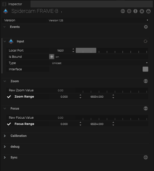

IO Connection
Input:
Local Port needs to be matched with the Spider system.
Interface needs to be the local IP which is connected to the Spider network.
Zoom:
Spider is sending the raw encoder values.
The range needs to match with the real lens to drive the 0-100% correctly.
Focus:

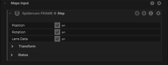

Map Input
A Spidercam map input can be used within a Camera object.
Click this icon to range the incoming Values.
