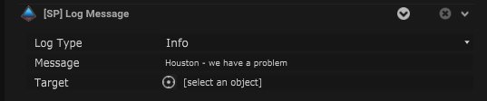

Log Message
When the target object caused the trigger it will cause the log message.
Name |
Description |
Log Type |
- Info – This is the trigger for an information message.
- Warning – This is the trigger for a warning message.
- Error – This is the trigger for an error message.
Message |
The message can be typed in the text box. |
Target |
This is the object or protocol which interacts with the area. |

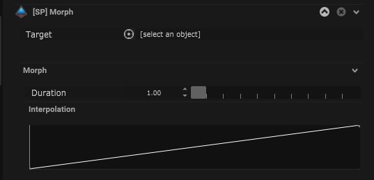

Morph
The morph event is a movement trigger, the trigger causes the target object to move.
Name |
Description |
Target |
Morph Duration |
This is the time it takes to get from the starting position to the end position. |
Interpolation |
This is the movement speed or curve. |

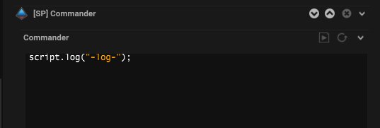

Commander
Name |
Description |
Commander |
The script can be written in the commander box to affect the target parameter. |
