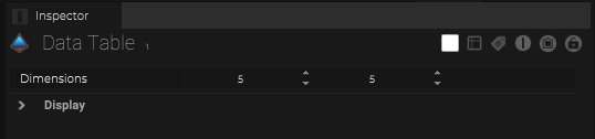

Setup the Data Table
If the Data Table object is selected in the pool tree, it´s possible to define the table size within the Inspector.

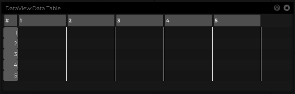

Open the Data Table View / Set values manually
A secondary click on the Data Table object within the pool -> “Open Data Table View”
Within the viewer its possible to edit or add values for a single entry by a double click on it.

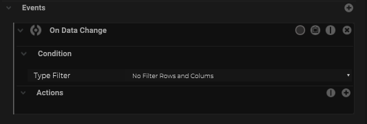

Data Table events
This event react on changes within the table.
Following filter are available:
- No Filter
- Filter for Row
- Filter for Column
- Filter for Row and Column

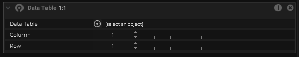

A DataTable needs to be linked, and the field needs to be defined.

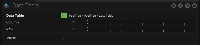

Data Table nodes
Nodes to access the data table entries or to write these can be added by drag and drop the Data Table pool object into a board.
Within the inspector the column and row needs to be define to read/write the correct entry
