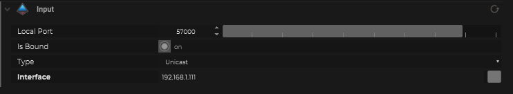

Setup the SMT IO Connection
Add the SMT IO within the IO Connections.
define the port and the local interface
Please make sure, that you selecting the correct “Length Unit” within the IO-Connection.
- Yards
- Meter
- Centimeter
- Feed
- Inch

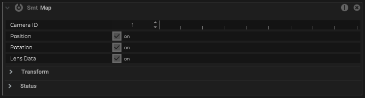

SMT Camera Map
The Camera ID is an optional identifyer, but needs to be set if defined within the SMT system.
Position, Rotation and Lens Data can be disabled optional.
The SMT Map deliverd:
- Position
- Rotation
- Fiel of View
- Lens Distortion Parameter
