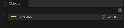

Add Sensor
Within the object tree navigate to sensors and choose “Ultraleap”.
Choose device

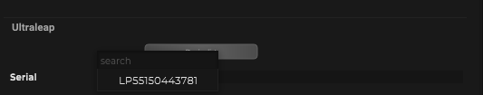

Within the inspector click on the button “Devicelist”.
Select the device with the given serial number.

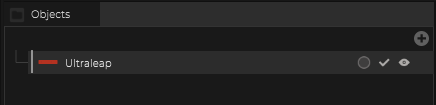

When the device is connected, the object within the object tree should be green instead of red.

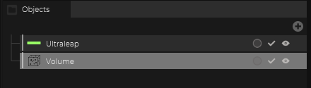

Using the volume object instead of nodes
Add a volume object within the object tree
Within the volume, add a map input:
Volume -> PointData -> And select as “Point Data Provider” the Ultraleap sensor
Each hand will now create a point.
