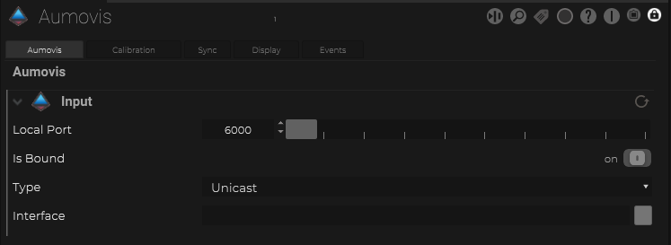

Aumovis Setup
Input
Name | Description |
Local Port | This is the port that will receive data from other devices. |
Is Bound | This will be on when the IO connection is bound to a network. |
Multicast Connection | When on, data can be sent to multiple recipients. |
Multicast Target IP | This is where the IP address of the multicast can be entered. |
Interface | This is the IP address of the local network interface (NIC) which should be used for this connection. |

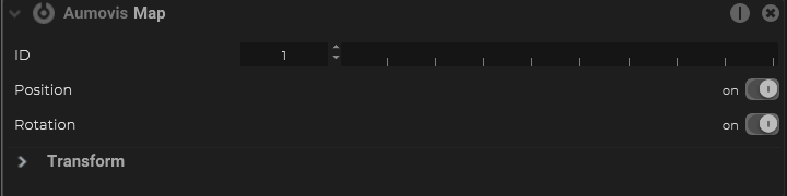

Aumovis Mapping
Input
ID | This is the ID number of the tracking point. |
Position | When on, the position of the object will be affected. |
Rotation | When on, the rotation of the object will be affected. |
