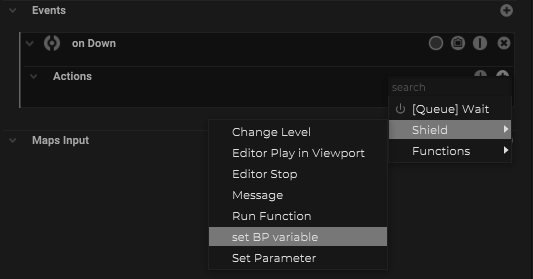

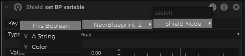

Control the parameter with a node
Drag and drop the Shield IO into the Board.
choose the BP variable node
