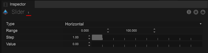

All objects and elements in Stage Precision has an unique identifyer.
If you select an object you can see a smal number behind the object name:
In this example you can see the number “1”.
Means, that this object is “Slider1”.
Each object has this number and it´s always unique within this type.
So that means, that a second Slider will have the number 2 and so on.
