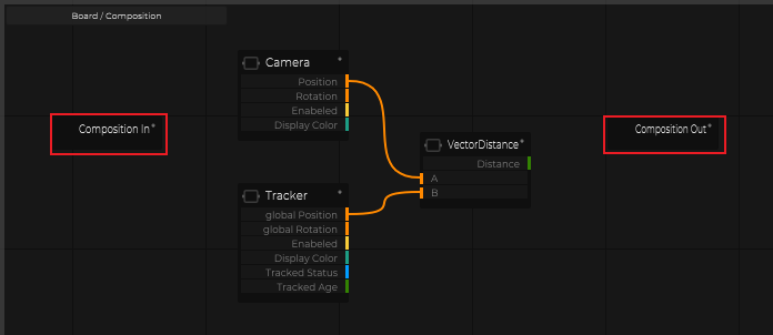

Add Parameter
Select the “Composition In” or “Composition Out” nodes to add Parameters.
This Parameters can be reached from outside.

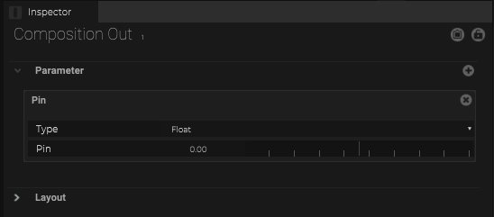

A click on the (+) add a connections.
The type needs to be defined.:
The pins needs to have a connection to forward the data.
The Composition Node has now the added parameters.
