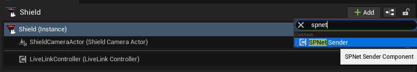

With the Shield plugin, it is possilbe to send data from UE to other destination via SPNet.
To do this, you can go into the object inspector and add a component called “SPNet Sender”

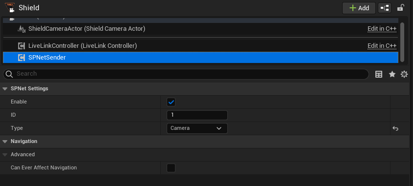

Once the component has been added, you can configure the SPNet Sender
Define the type of object it is, and assign an ID to the object.
