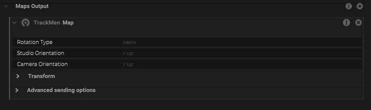

Adding a map output
Within Stage Precision it´s also possible to send out the TrackMen protocol.
Enable the “Output” within the IO Connection and define the remote host and port.
Simply add a map output to a camera object.
