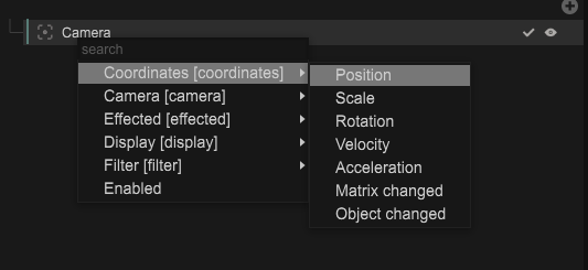

You also can release the target cursor on top of an object wich will appears a menu with all paramaters from this object.
You can now navigate through the menu to choose a parameter wich will be linked into the target parameter.
