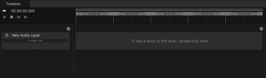

An audio layer can be added by using the + button in the timeline.
To add an audio track, double-click the audio layer part of the timeline. This will open up a file explorer and the audio track can be located.

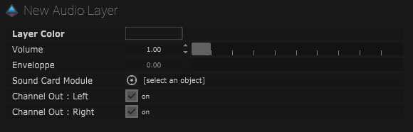

Audio layer parameters can be edited in the inspector.
Audio Layer Parameters
| Layer Colour | Clicking the colour box opens a colour picker with RGB (red, green, blue) and alpha control. |
| Volume | The volume of the audio track can be adjusted. |
| Envelope | B4 |
| Sound Card Module | The specific sound card input can be selected. |
| Channel Out: Left | When on, the audio layer will be output by the left speaker. |
| Channel Out: Right | When on, the audio layer will be output by the right speaker. |
Block Setup
| Time | The start time of the block can be manually added here. |
| Length | The length or duration of the block can be added manually here. |
| Locked | If ticked/on the block will be locked on the timeline. |
| Colour | The colour of the block can be altered here. |
