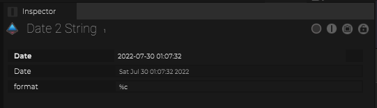

Format
The date output connection can be custom modifyed.
| specifier | Replaced by | Example |
| %a | Abbreviated weekday name * | Thu |
| %A | Full weekday name * | Thursday |
| %b | Abbreviated month name * | Aug |
| %B | Full month name * | August |
| %c | Date and time representation * | Thu Aug 23 14:55:02 2001 |
