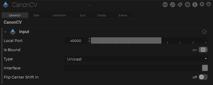

For Canon cameras equipped with Cana lens that supports virtual production, it is possible to extract the metadata from the camera and map that to a camera object.
Connection
| Local Port | This is the port that will receive data from other devices. |
| Is Bound | This will be on when the IO connection is bound to a network. |
| Multicast Connection | When on, data can be sent to multiple recipients. |
| Multicast Target IP | This is where the IP address of the multicast can be entered. |
| Interface | This is the IP address of the local network interface (NIC) which should be used for this connection. |
| Flip Center Shift In | Toggle to flip the center shift or not |
Connection to a Camera
Create a camera object and create a Canon CV Map In to get the lens values connected to a camera object
