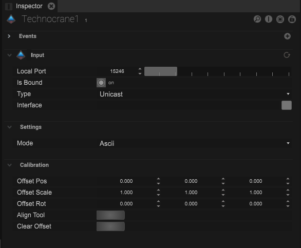

The Technocrane is a camera crane system, this is the input for the crane tracking system.
Input
| Local Port | This is the port that will receive data from other devices. |
| Is Bound | This will be on when the IO connection is bound to a network. |
Mode
| Mode |

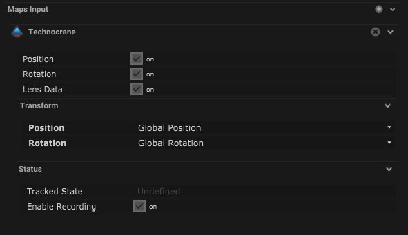

Technocrane Mapping
With an Map Input the Data of this IO will be mapped into the defined object,
Maps In
| Position | When on, the incoming position data will be used. |
| Rotation | When on, the incoming rotational data will be used. |
| Lens Data | When on, the incoming lens data will be used. |
| Position |
| Rotation |
Status
| Tracked State |
| Enable Recording | When on, the input data can be recorded. |
