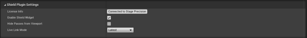

General Shield Plugin Settings
| Setting | Description | Change in play | SP control |
| License Info | Shows the actual status to Stage Precision. If connected, Shield is activated |
| Enable Shield Widget | Enabled the Shield Widget within the viewport rendering. | |
| Hide Passes from Viewport | If checked, all objects which are defined as “special objects for passes” will be hidden within the viewport during editing. This includes objects like: |
| Live Link Mode | Defined the default “Evaluation Mode” for the Live Link connection. Live Link connection must be removed and added again so that the settings are accepted. |

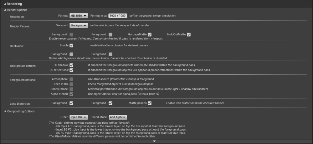

Rendering
Render Options
Resolution:
| Format | Choose the supported project resolution:
Render Passes:
| Viewport | Define which pass should rendered by the viewport:
| Background | enable/disable the Background render pass Can´t be choosen if pass is rendered from viewport. |
| Foreground | enable/disable the Foreground render pass. Can´t be chosen if pass is rendered from viewport. |
| Garbage Matte | enable/disable the Garbage Matte render pass. | |
| HoldOut Matte | enable/disable the HoldOut Matte render pass. | |
Occlusion:
| Enable | enable/disable occlusion in general | |
| Background | enable/disable occlusion for the background. | |
| Foreground | enable/disable occlusion for the foreground. | |
Background options:
| FG shadow | if checked the foreground objects will create shadow within the background pass. | |
| FG reflection | if checked the foreground objects will appear in planar reflections within the background pass. | |
Foreground options:
| Atmosphere | use atmosphere show flag for the foreground pass. This effects among other things “Volumetric Clouds”. |
| Keep in BG | Foreground objects stays also in BG. | |
| Simple mode | Don´t create shadow clones from the background environment into the foreground if enabled. This could effect the look of the foreground objects but needs less performance. If disabled, the foreground objects fit better into the background pass. (default) |
| Alpha Stencil | By default enabled, use the alpha stencil for foreground objects like the UE default. If disabled, the alpha pass will be also effected by post fx. |
Lens Distortion:
| Background | Enable/disable lens distortion for background render pass | |
| Foreground | Enable/disable lens distortion for foreground render pass | |
| Matte passes | Enable/disable lens distortion for matte render passes | |

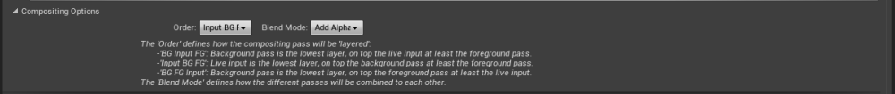

Compositing Options
| Order |
| Blend Modes |

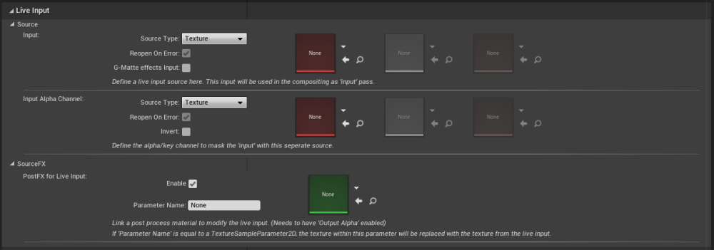

Live Input
Source
Input:
| Source Type | Type which will be used as Live Input.
| Reopen On Error | If a source lost the signal, the engine tries to reconnect until the signal is back. This only have an effect for the Media Source and Media Bundle Can effect the engine performance if the signal lost continuously |
| G-Matte effects Input | If checked, the Garbage Matte render pass will be used as alpha stencil for the live input. For combined render pass only! |
Input Alpha Channel:
| Source Type | Type which will be used as Live Input Alpha Channel.
| Reopen On Error | If a source lost the signal the engine tries to reconnect until the signal is back. This only have an effect for the Media Source and Media Bundle Can effect the engine performance if the signal lost continuously |
| *Invert * | If checked, the alpha channel will be inverted. | |
SourceFX
Post FX for Live Input:
| Enable | Enable the use of post effect materials to effect the live input | |
| Parameter Name | The parameter name wich needs to match a “TextureSampleParamter2D” within the choosen material. | |

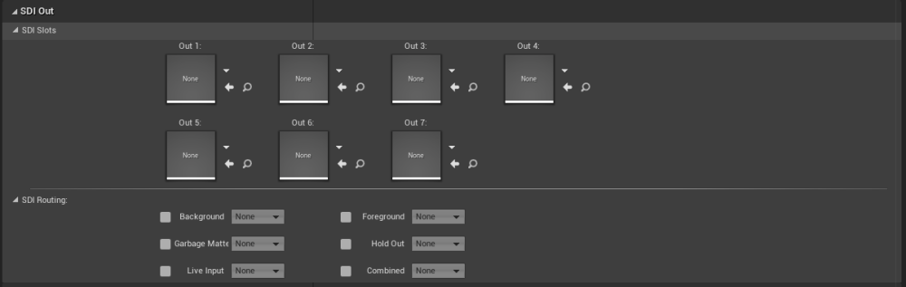

SDI Out
SDI Routing:
| Define the SDI output slot for the different render passes |

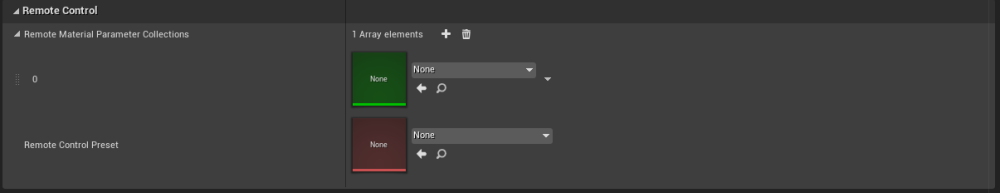

Remote Control
Remote Material Parameter Collections
Array with slots for different “Material Parameter Collections” to remote control these from Stage Precision.
Remote Control Preset
Slot for a “Remote Control Preset” to remote control any parameter from Stage Precision.
Must be defined before play.
