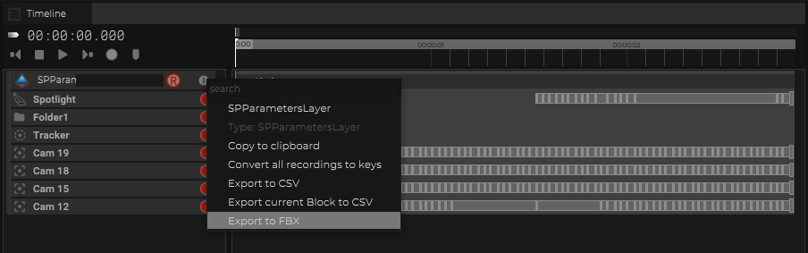

FBX export
With a click on the (I) within a recording layer opens a menu.
Click on “Export to FBX”.

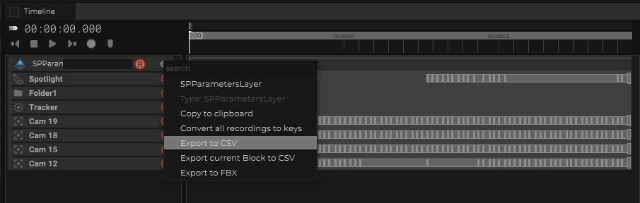

CSV export
Click on “Export to CSV”.
Within the first row of the CSV is the header.
| “Index” | “Time” | “Timecode” | “Position X” | “Position Y” | “Position Z” | “Rotation X” | “Rotation Y” | “Rotation Z” | “Field of View” | “Resolution X” | “Resolution Y” |
“Index”, “Time” and “Timecode” are always the first culomns, followed by changed parameters, followed by fixed parameters.
The second row is an initial entry to define the fixed parameter.
To identify the initial values we used as index a “-1”.
| -1 | 90 | 1920 | 1080 |
This means, that “FoV” and “Resolution” has not any changed values within this recording.
From the third row for each frame will be a single row with all changed parameters.
| -1 | 90 | 1920 | 1080 | ||||||||
