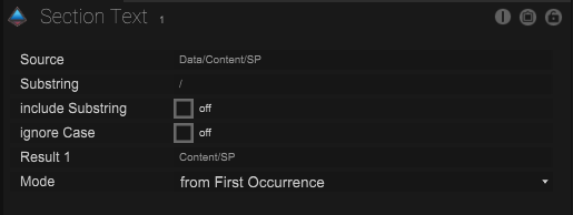

Section Text Setup
| Source | This is the input text. |
| Substring | This is the substring input. |
| Include Substring | Include/Exclude the substring into the result. |
| Ignore Case | Define if the substring should be case sensitive or not. |
| Result | This is the output result. |
| Mode |

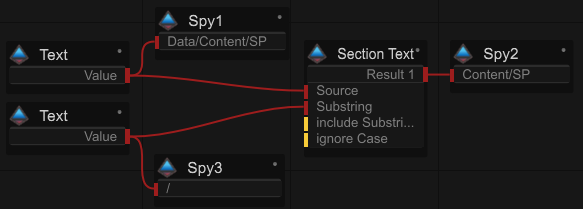

Example “From first Occurrence”
In this example is the input “Data/Content/SP”.
The substring “/” will be used to seperate the input string.
Everthing behind the first “/” will be used.
The result is “Content/SP”.

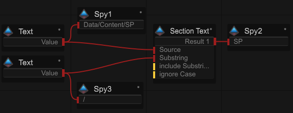

Example “From last Occurrence”
Everthing behind the last “/” will be used.
The result is “SP”.

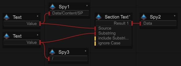

Example “Up to last Occurrence”
Everthing before the last “/” will be used.
The result is “Data/Content”.
