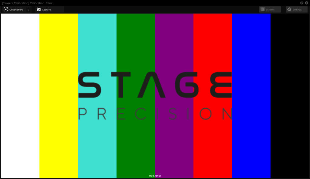

Reposition Calibration Widget
At the top left of the Calibration widget, go into the settings tab and select an image provider. Once the image provider is selected, the preview window display the live feed.
Next, go into the Screen tab and select the calibration screens.
With an live feed configured and calibration screens associated for this calibration, the process of capturing images for observation can begin. Press to “Capture” button in the top left corner of the widget.
Once a frame has been captured, the system would analyze the frame and reports back whether it was a successful observation or not. In the bottom left corner of each observation, it would either say “#Failed” if the observation did not work; or #e.x.xxx for the error margin of the observation.
Once sufficient observations has been captured, return back to the camera object inspector, under the Tools tab, locate the Reposition tool and press the “play” icon in the header of the tool to apply the transformation to the target object.
Once the reposition has been applied, can check on the target object and see a translation in the coordinates should be applied.
