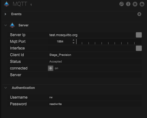

This IO Connection is node-based, this worked with “MQTT Topic” nodes for receiving the data packages and “MQTT Puplish” to send data packages within the board.
MQTT IO Connection
| Server Ip | Is the IP address of the MQTT server (broker). |
| Mqtt port | communication port of the MQTT server (broker) |
| Interface | This is the IP address of the local network interface (NIC) which should be used for this connection. |
| Client ID | This is the client identifyer for this IO Connection which will be used to subscripe to data packages on the MQTT server (broker) |
| Status | The feedback of the server (broker) |
| connected | boolean for connection status |
| Username | Username wich can be used for an authentication |
| Password | password wich can be used for an authentication |

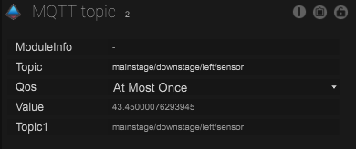

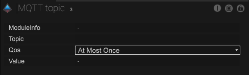

MQTT topic subscribe node
| Topic | a string (path) that the server (broker) used to seperate the data packages for each connected client. |
| Qos | QoS level |
| Value | returns the values from the seperatet data package (broker) |

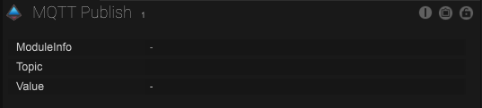

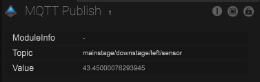

MQTT Puplish node
| Topic | a string (path) to write data to the server (broker). |
| Value | value which will write to the server (broker) |

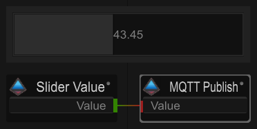

example use of puplishing simple data
To send one simple value to the server (broker) link the desired value to the MQTT puphlish node.
select the node and define the topic (path) where the data should be “stored” on the server (broker).

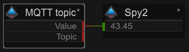

example use of subscribe to simple data
To subscribe to data from the server (broker) define the topic (path) where the data is “stored”.

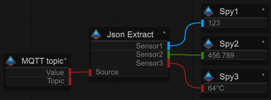

example use of subscribe to JSON data
MQTT can also handle JSON formated string structures.
You can use a JSON extract node to access subparameter of the JSON string.
More about the JSON extract node see here.
