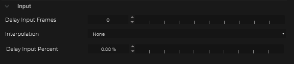

Delay Input frames
Whenever it´s necessary to add full frame delays to the incoming data packages, just increase this value.
Interpolation
Whenever the incoming data packages needs an interpolation.
Might be necessary when the protocol fps is not equal with the fps of the SP project,
or to generate subframe interpolations.
- None
- Subframe
- Fixed
- Time Based

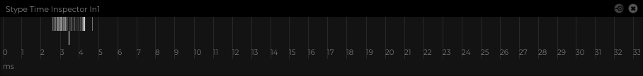

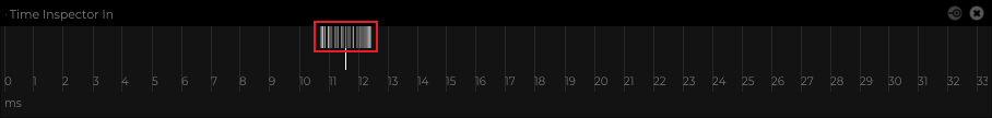

Time Inspector
The Time Inspector shows incoming data packages within one frame.
To open the Time Inspector click within the IO on the icon.
The upper lines are showing a history of the timing from the incoming data within a frame.
The lower single line is the average from the received data timing.

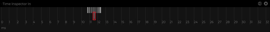

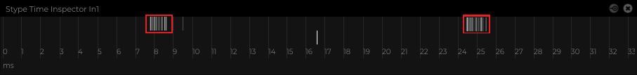

When the incoming data framerate is faster then the SP process time,
the Time Inspector will show multiple accumulations.

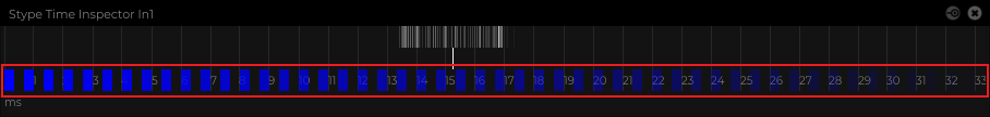

If the incoming data frame rate is slower then the SP process time,
a blue drop Indicator will be drawed per missing data package.

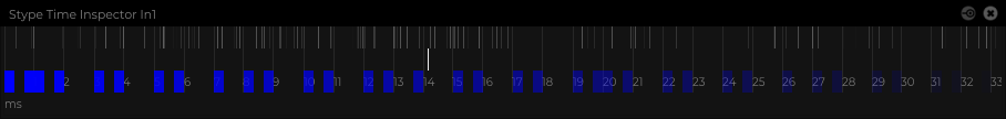

If the timing of incoming packages is neither constant and doesn´t match the frame rate,
the Time Inspector will be looked similar like this.
Delay Input Percent
To shift the incoming data packages within a frame to place these perfectly into the SP calculation.

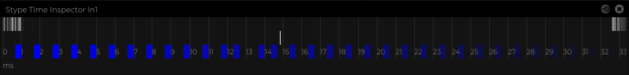

In a case that the incoming data framerate is matching, but the packages are coming in exactly between the frame end and the frame start,
it´s possible to shift the incoming packages slightly within the frame to match perfectly the SP frame.
After defining the offset the packages are fitting perfectly within the frame.
