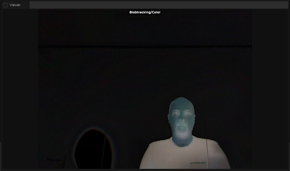

Doing Blob Detection from the provided Image
- Within the sensor object, under the Maps section, add a Blobtrtacking Clustering filter.
- Before continuing, it is a good idea to open up a Viewer window to preview how the blob detection algorithm is working. Right click on the Viewer window, and select “Blob Detection/Color”.

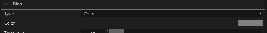

- If the sensor is a standard RGB or BW image, select the color value that should be used as an identifier for an object of interest. Adjust the Threshold so that the cut out works best for your application

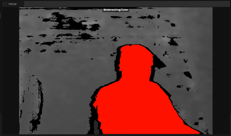

- If the sensor is a depth camera, chose the type to be Distance and adjust the greyscale value for the front and back plane to define your detection zone.
- Fine tune the Min Radius and Max Radius to help ignore false positive for the blob detection

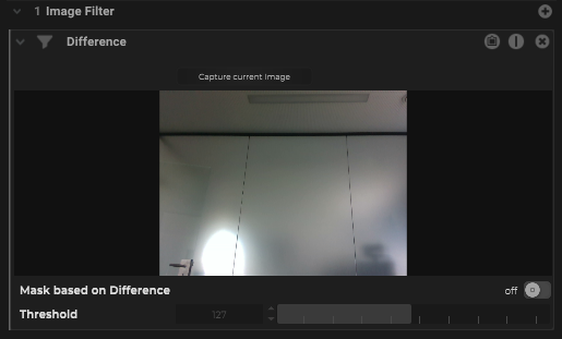

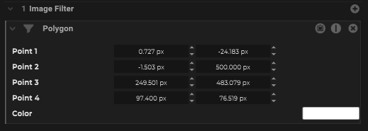

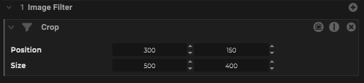

SP provides additional filters for you to clean up the base image to better extract the objects out of an image. Below is a list of them:
| Name | Settings | Viewer |
| Crop | |
| Polygon | |
| Mirror | |
| Difference | |
