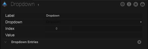

A Dropdown can be created within any Board.
With this interface it´s possible to create an own dropdown menu with custom names and custom parameter for each dropdown entrie.

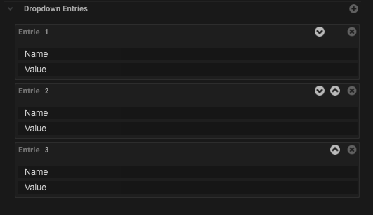

Dropdown Entries
A click on the (+) create a new entrie.

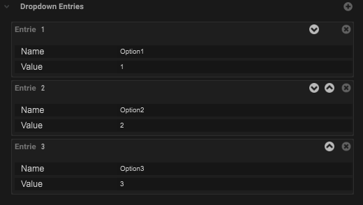

Each entrie can have a custom name and also a custom value.
A value parameter can handle multipe types:
- Float – needs to be numeric values splittet with a dot for decimal values.
- Integer – needs to be numeric values without decimals.
- String – can be any character or number.
- Bool – can be “1” / “0” or “true” / “false”

To get access to the Dropdown, check the unique ID of the object within the Inspector. See here.
