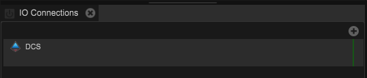

The DCS IO can be added with a click on the (+) within the IO Connections.
Within the Inspector the DCS device IP and the local interface needs to be defined.

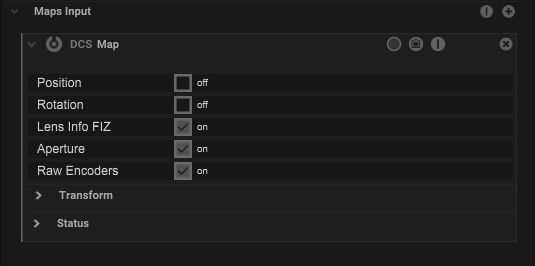

To link the incoming DTS lens data to a camera object it’s necessary to add a map input.

Map Input
The map input has multiple check boxes to enable/disable different package types from the ncam protocol.
| Position | Position values |
| Rotation | Rotation values |
| Field of View | Field of View value |
| Focus Distance | Focus Distance value |
| Aperture | Aperture value |
| Raw Encoder | Raw encoder values from 0-100% (Focus / Zoom / Iris) |
