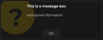

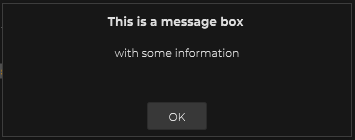

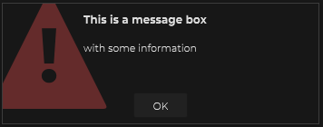

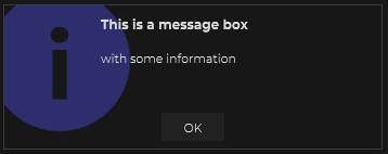

util.showMessageBox("title", "message");
generates a message box
util.showMessageBox("title", "message", "optionalType");
the box type can be changed (optional)
util.showMessageBox("This is a message box", "with some information");
util.showMessageBox("This is a message box", "with some information", "warning");
util.showMessageBox("This is a message box", "with some information", "info");
util.showMessageBox("This is a message box", "with some information", "question");

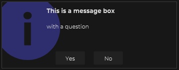

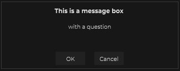

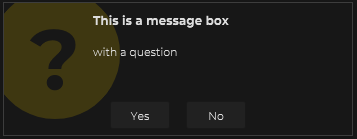

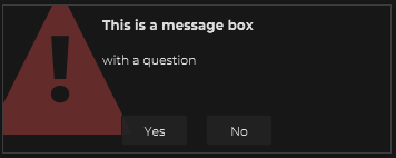

util.showOkCancelBox("title", "message");
generates a message box with two options
the first options returned 1, the second option 0
util.showOkCancelBox("title", "message", "optionalType", "optionalLabelOK", "optionalLabelCancel");
the box type can be changed as well as the button labels (optional)
util.showOkCancelBox("This is a message box", "with a question");
util.showOkCancelBox("This is a message box", "with a question", "warning", "Yes", "No");
util.showOkCancelBox("This is a message box", "with a question", "info", "Yes", "No");
util.showOkCancelBox("This is a message box", "with a question", "question", "Yes", "No");

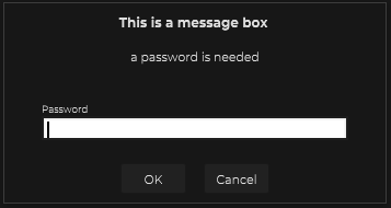

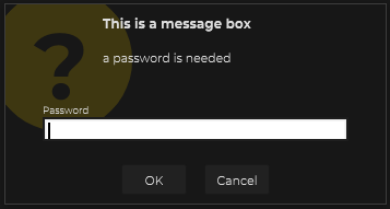

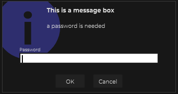

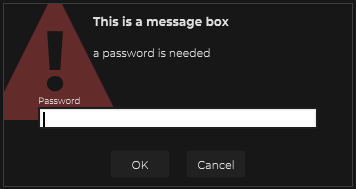

util.showPasswordBox("title", "message");
generates a message box with a password field
returned the password as string
util.showPasswordBox("title", "message", "optionalType");
util.showPasswordBox("This is a message box", "a password is needed");
util.showPasswordBox("This is a message box", "a password is needed", "warning");
util.showPasswordBox("This is a message box", "a password is needed", "info");
util.showPasswordBox("This is a message box", "a password is needed", "question");

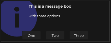

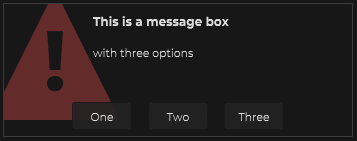

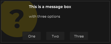

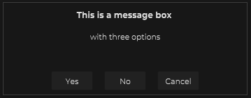

util.showYesNoCancelBox("title", "message");
generates a message box with three options
the first options returned 1, the second option 2, the third option 0
util.showYesNoCancelBox("title", "message", "optionalType", "optionalLabelYes", "optionalLabelNo", "optionalLabelCancel");
util.showPasswordBox("This is a message box", "with three options");
util.showPasswordBox("This is a message box", "with three options", "warning", "One", "Two", "Three");
util.showPasswordBox("This is a message box", "with three options", "info", "One", "Two", "Three");
util.showPasswordBox("This is a message box", "with three options", "question", "One", "Two", "Three");
